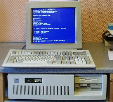

OS-9 running on a Peripheral Technology CD68X20 motherboard installed in an IBM PC-AT case. The keyboard is the original IBM PC-AT one but the monitor is a Phillips unit.
The Peripheral Technology motherboard has a Baby-AT footprint, so some determined metal-work had to be done before it could be installed in the PC-AT case. It is powered from a standard PC power supply. The 25 MHz 68020 processor and ROMs are mounted on a replaceable daughter board. Memory is a set of four 32 bit 100 nS SIMMs, providing 8 MB of RAM - enough to run any application I've needed to run despite the presence of a 1.46 MB RAM-disk. A standard VGA display card is installed in one of the five ISA slots on the board, but its built-in ROM is ignored. The keyboard plugs into the usual DIN socket. The board has on-board IDE and a floppy controllers as well as sockets for a SCSI interface. Four serial ports and a parallel port are fitted as standard: all connect to the outside world via flying leads that terminate in standard D-connectors mounted on adapter slot blanking plates.

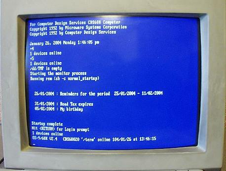

Screen close-up showing the OS-9 boot display
This is my usual boot display. The actions defined in /dd/startup are:
The entire boot process takes under 30 seconds.
Shut down is equally fast: just log out and switch the power off. This is possible because OS-9 does not use cached writes in the interest of robust file management. There is obviously a trade-off against speed, but this is, in my opinion, offset by the protection against data loss and the fast boot and shutdown times.
